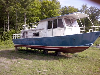

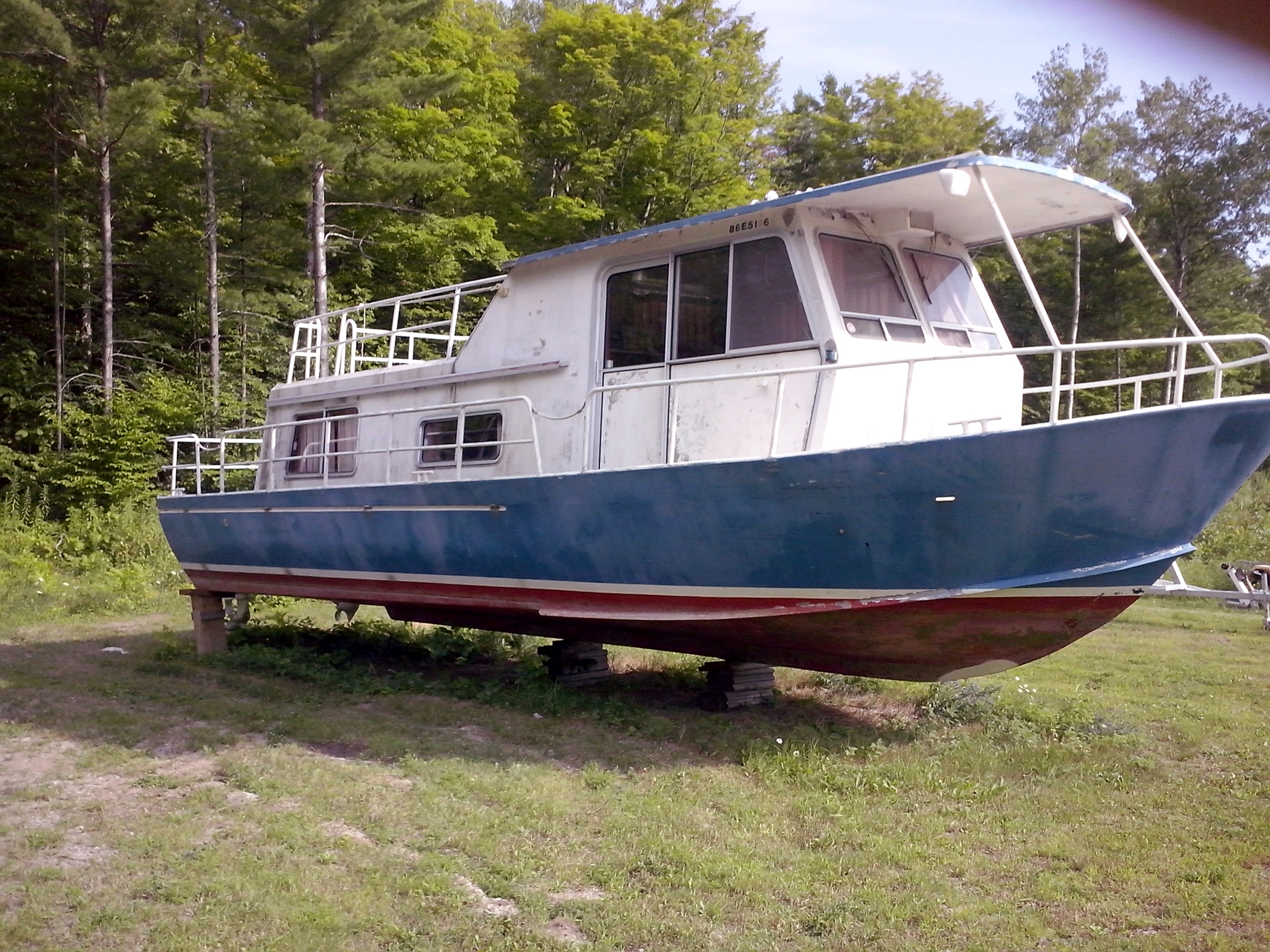

Have been following the forum for a while now, soaking in all the great info. I recently came across a 370 for sale and need some info in order to decide whether to make the purchase or not. The boat seems all original inside and both v6 motors I am told run. The exterior is another story with flaking peeling paint from top to bottom. Has anyone sand or soda blasted and what are the costs? What type of paints are required and also is the anti fouling paint required? I looked at it today and it seems to be in good condition but needs updating such as flooring upholstery window coverings etc. How bad would fuel costs be with the existing engines say just slow cruising for a day? Boat has great potential but would like to know what I would be up against. Thanks for any advice.

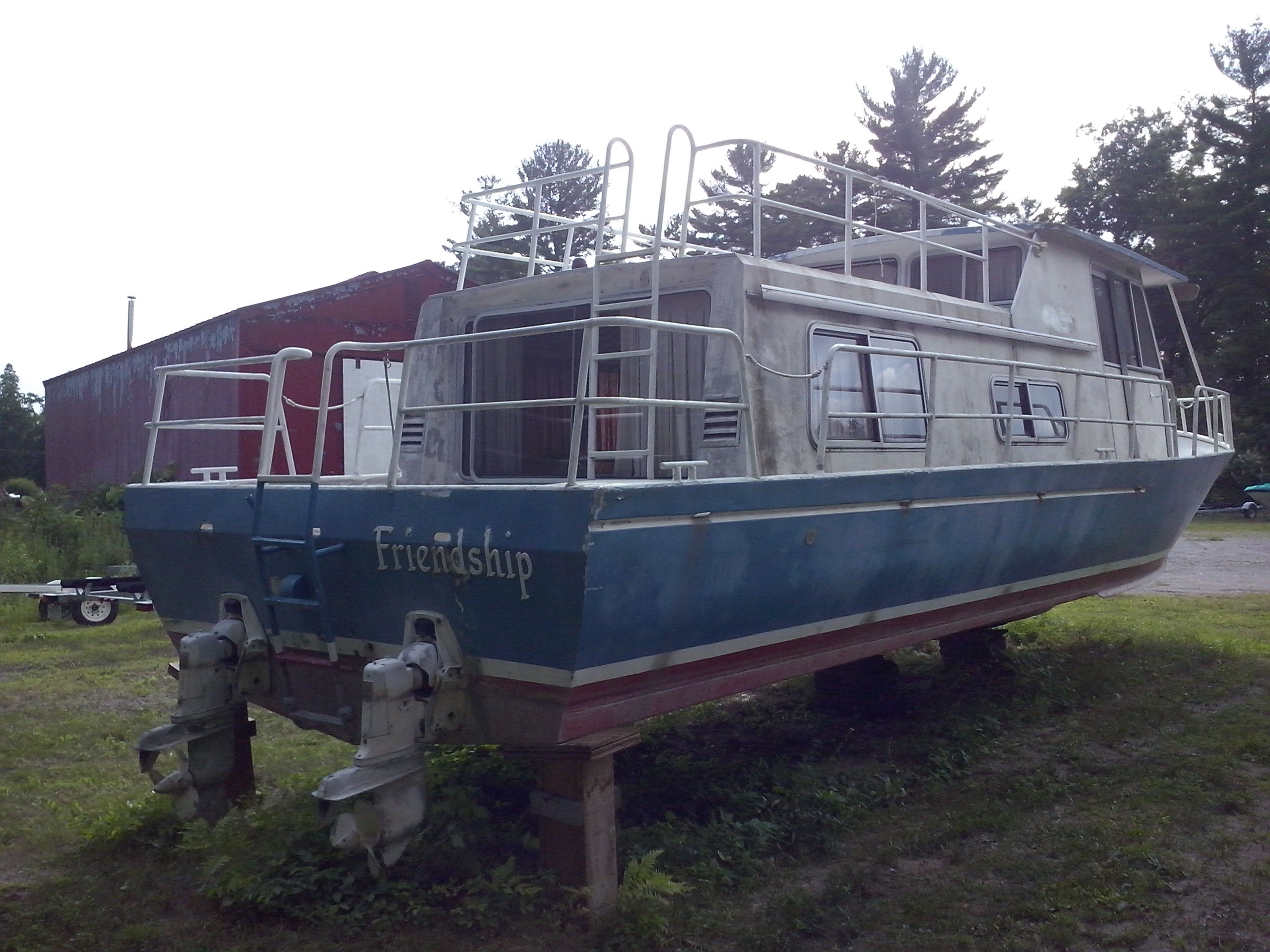

Well I did it! Picking up "Friendship" in 2 - 3 weeks!
I have my work cut out for me...but hopefully can use her "as is" this year...

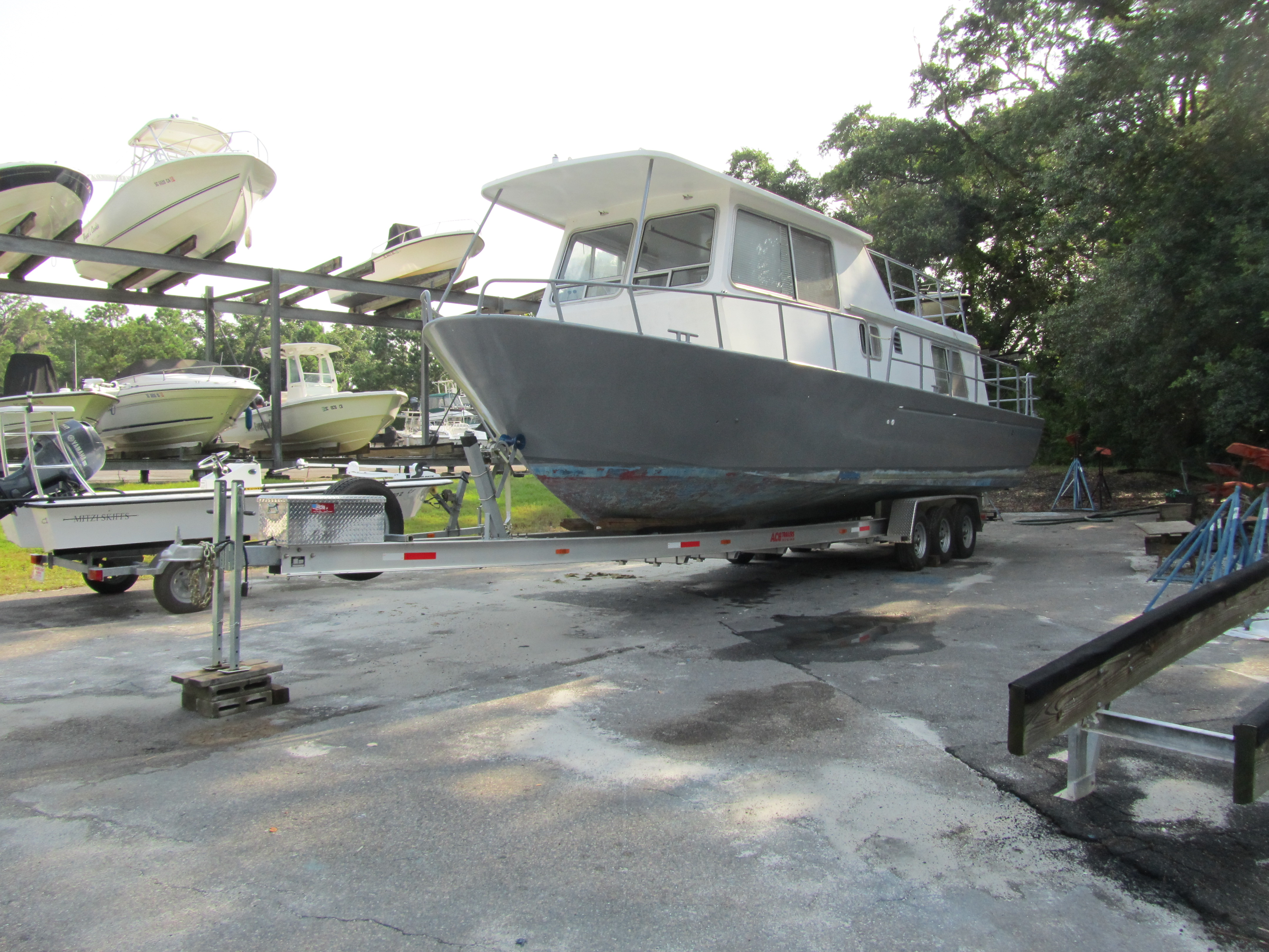

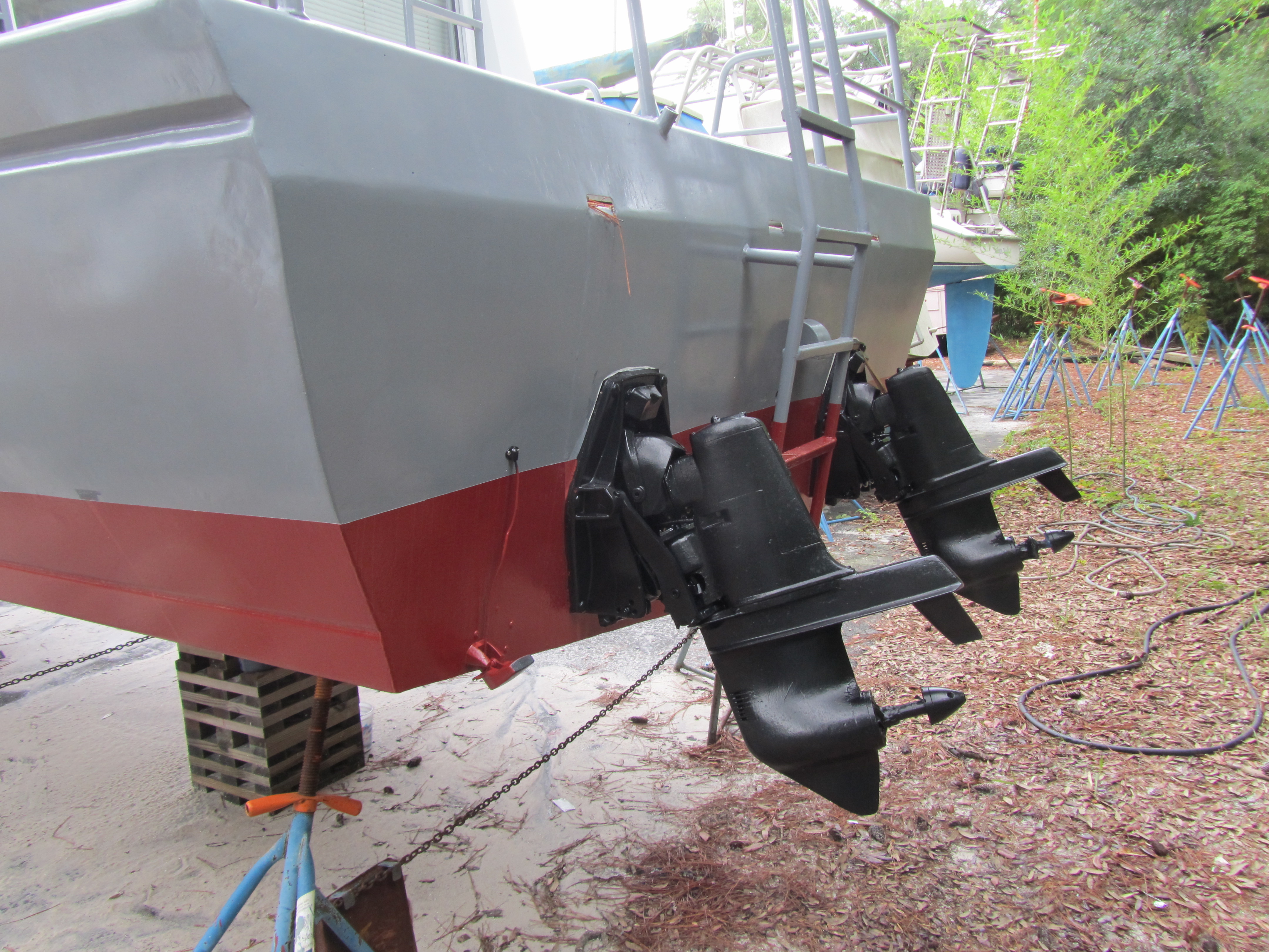

We have the same boat. I bought mine in 2012 and hand sanded the hull and reworked the inside for two years. I launched it last year and it has been my live aboard during the week in Charleston S.C. til last Friday. I just hualed her to get repowered with outboards :).....
If you're sand blasting you're doing it right. I sand blasted below the water line and put 3 coat of Inter Protect and two coats of Inter protect Plus.. Picture show before and after one year in Salt water.
Good luck!
wallyg
Posts: 49
Re: 370 questions
Post by wallyg »
One more (after one year in salt water)!
