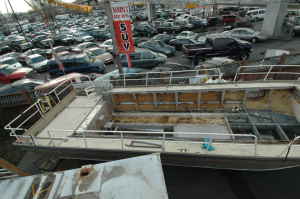

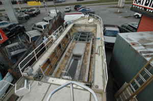

Check out the post from WaterCottage on Oct 11th in the Alcans for sale forum. (37 Foot Hull for Sale)
The pics of the stripped down hull show those longitudinal stringers. My keel looks fine but I guess I've been getting away with murder.

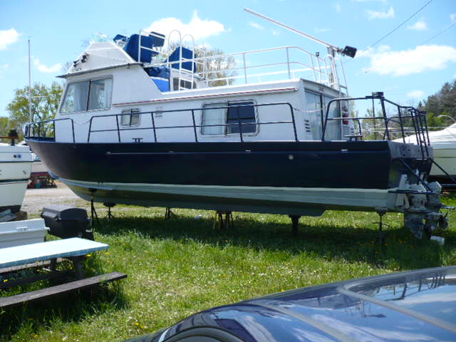

SIOUX has for the past 20 years been stored on blocks and or stands. For the past ten years we have used 3 steel stands under the keel. The weight of the boat is set down on the stands. Then, adjustable stands are placed at the transom and just aft of the start of the spray rail.
In view of the other comments we will have to rethink this method.

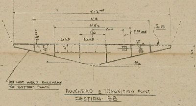

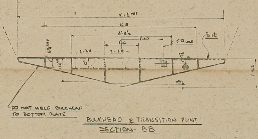

Folks
Take a look at this picture: It is from the one of the drawings in the blueprints section:
http://www.alcanboats.com/BluePrints/Bu ... ent%20.JPG
It doesn't show the keel, but it does show that the keel has nothing other than the thin hull skin to support it. There is lateral support for the longitudinal stringers only.
So... I have had a bent keel. My Dad has had a bent keel. According to his post, Rob has had a bent keel. All from supporting weight on the keel.
Unless there is some compelling reason to put blocks under the keel, don't do it. Add more blocks at the chines. If you need support down the center line, use supports at the transom and well ahead of the keel.

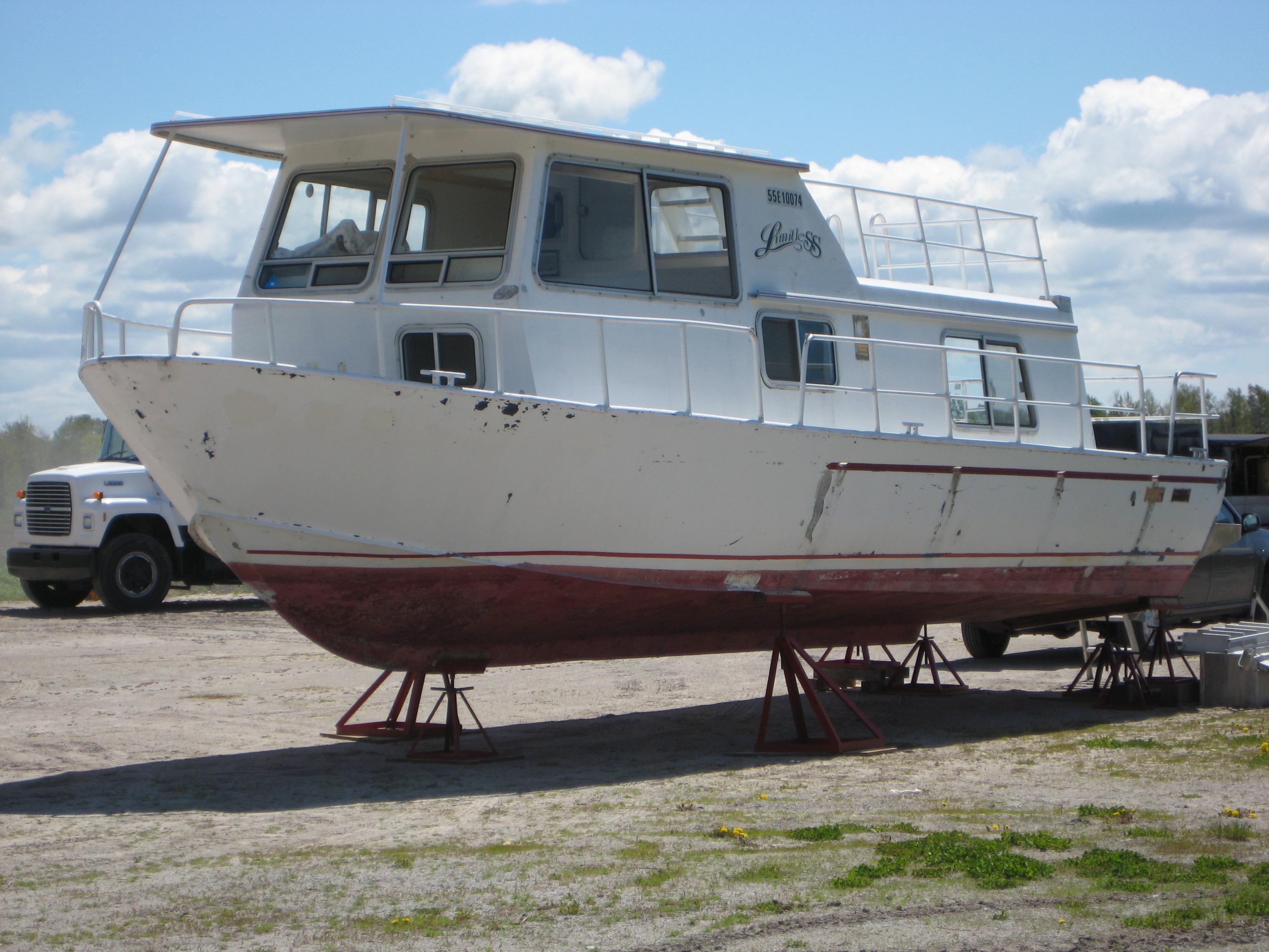

I have been trying to attach a picture of SIOUX on stands for Winter storage. I now have the formula for doing so thanks to Terry.
Brian - SIOUX
Brian - SIOUX

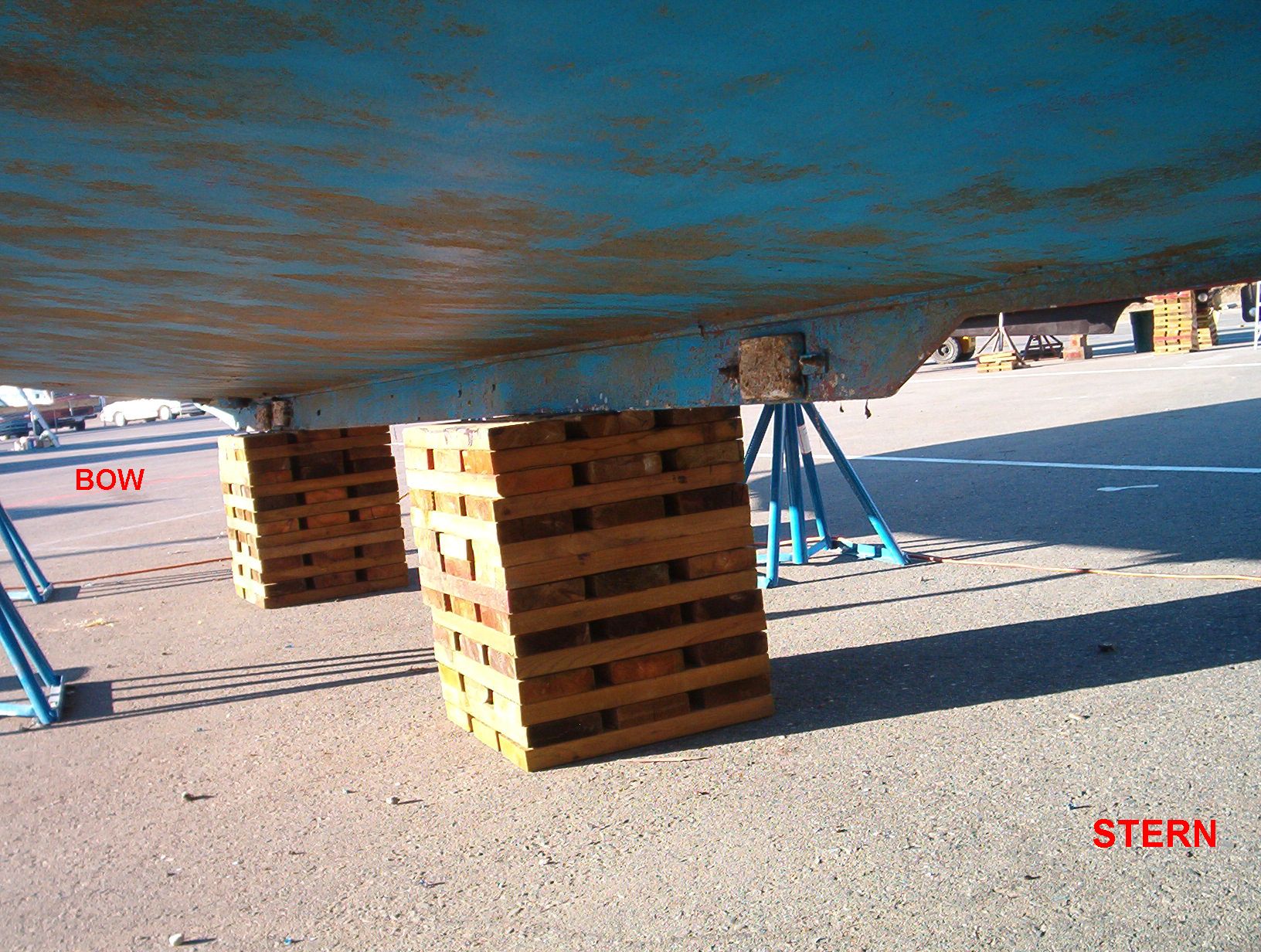

I was never impressed with the flimsy keel on my 30'. The boat has spent most of it's life in the water and hasn't been blocked up, except for haulouts.
The keel should have been a full length "V" of aluminum around 6-7" high, 4-5" at the top and tapering down so it could support the weight better.
The current keel is bent a bit and the only way I could see to straighten it and pull down slightly is some type of hydraulic set-up with a puller. Of course this isn't going to be happening soon, so I'll live with it.
As long as there are multiple chine supports, weight is less on the keel.
This shot is when I first got the boat...
