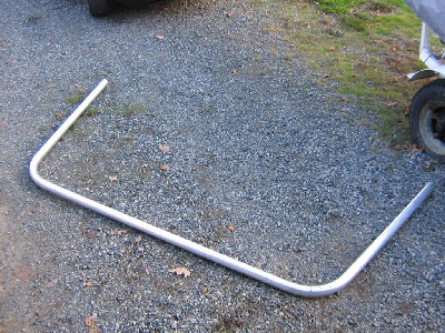

The first thing was to bend a perimeter. This is done with 6063 bendable grade aluminum. This just bends cold with a hydraulic bender - no heating required.
Straight pipe loaded. This is 2" pipe, which is 2 3/8" OD, a common size.

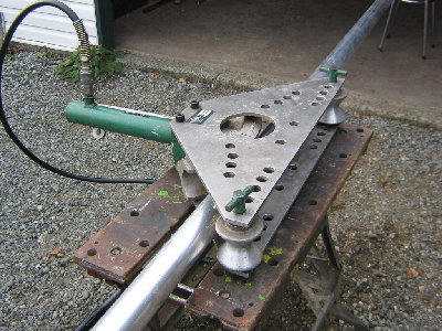

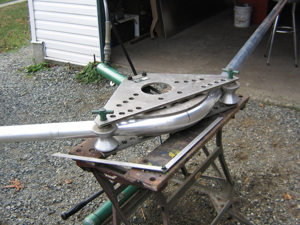

Pump lever (near ground) and die bends pipe.

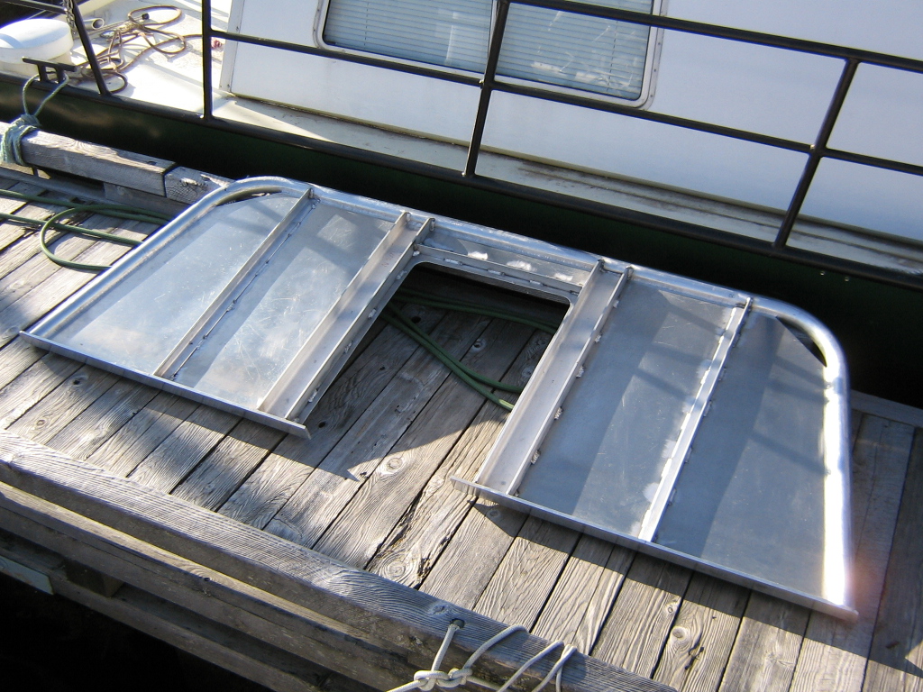

Sheetmetal (3/16") cut to size and welded in. An angled piece to match the transom was welded along the edge, and two 4" wide "C" channels were welded to mount the angle brackets on. Two smaller "L" angles were also added. Hole for sterndrive clearance cut out. Factory ladder was trimmed off and will be modified more in future.

Hole cut out for drive.  Angled flange on back, 4" mounting channel, and outer angles added.

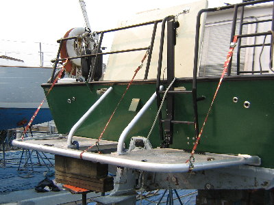

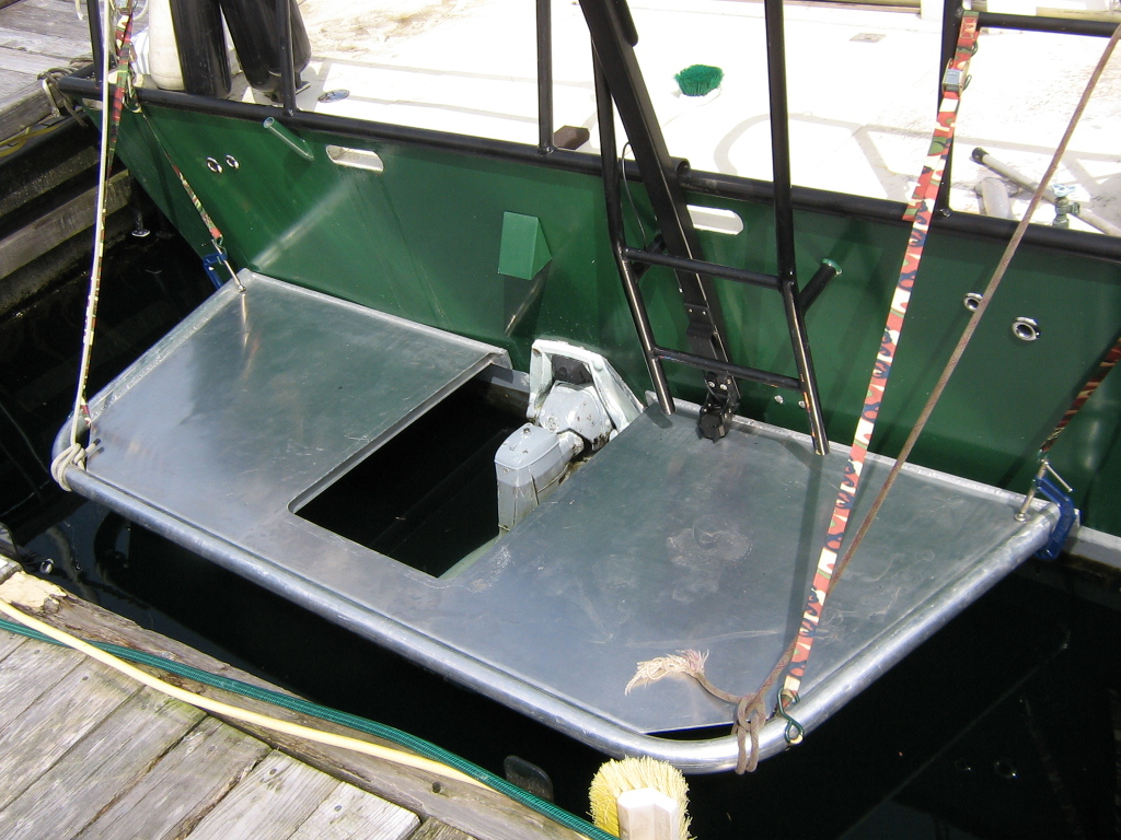

Hung off the back to get a feel. Device on ladder was raise-able depth sounder mount which will now need to be modified. <br />Note wavyness of transom.

BTW, the "wavy" transom seems to be a characteristic of all these boats. I know that mine is like that and I have helped with installing a swimgrid on another one that was just the same.
