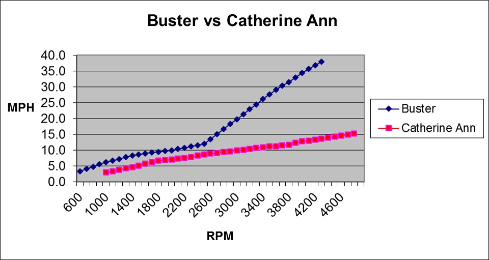

To add to David's info, Catherine Ann has the original 2 x 170 HP Volvo engines and does not reach planning speed. Although hull shape is identical to Buster (somewhat different than your Alcan 370) I estimate that my boat is 5000 lbs heavier than David's. Flybridge, teak decks, stainless and wood railings, residential fridge, generator, new cabin sheathing, etc . . . all add up. 17,000 lbs vs 12,000 lbs (or less). Side by side, my boat sits 2" deeper in the water than David's. The "floating cottage vs the speedster" !
All this to say that boat weight is as critical as hull shape to reaching planing speed. Your boat originally planed with about 340 HP. Before deciding on repower HP, it would be good to get an accurate weight of the boat and compare this to original specs.
Plotting Speed vs RPM for Catherine Ann vs Buster, looks like this:
