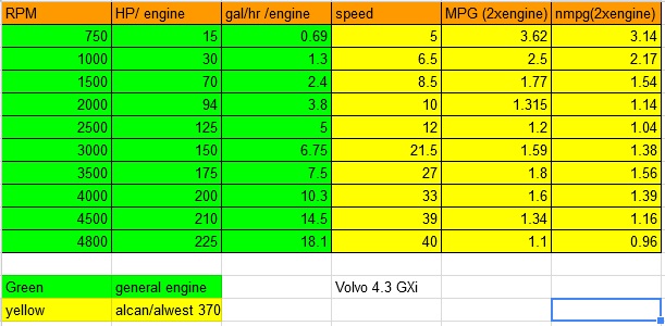

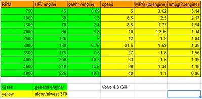

Hello,
interesting data. Being on the market for an alcan 370, i did take some data over the internet about boat fuel usage, hp and milleage.I did find 4.3 vortec power curve and a site called boat fuel usage give idea of fuel consomption at a given RPM. i melted all these data to create that somehow imprecise ( particulary HP at 750 , 1000 rpm and over 4000 rpm ) spreadsheet. Then used the data you published on BBuster speed VS rpm to get the result you can see.
My result give something similar to yours, but im kind of surprise that your fuel usage is so linear. I would have tought that there was to be a sweet spot at around 3500 rpm giving the best fuel efficiency. Im curious about the ratio of your SX outdrive. Recently i had the chance to see another alcan 370 with the same power configuration (4.3 GXi) but i was surprise to see a 17 inch pitch on these aluminium 4 blades props, the SX outdrive had a ratio of 1.79 . I didn't try it, but he was claiming similar performance to yours, but no cavitation a low speed).
I did a similar sheet for the 5.7 and it show similar fuel usage by HP. ( the 5.7 use more fuel at lower HP but less in higher HP(200+) ). So I guess for the 370, 4.3 is a good economical choice.
sorry for my english, it' my second language.
the speed is shown in MPH not knots
Re: Fuel Economy
Nice analysis! I think once I get more data points that you will see the sweet spot around 3500RPM. I was more interested in the displacement speed fuel consumption as I was trying to figure out just how far we could go on our fuel supply. I need to take some additional readings to fill in the gaps. I will see if I can do that over the weekend.
