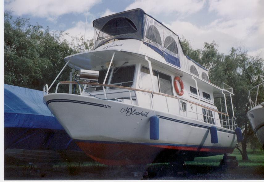

In 1993 I was seaching central Ontario for an Alcan/Alwest.
I snapped the attached picture of an Alcan (at Hurst Marine near Ottawa, I think)
This boat was not for sale, but I was intrigued by the molded fibreglass roof extensions, the bow thruster and the wooden handrails. Who knows, maybe this is where my handrail idea came from !
I also really like that bow thruster idea! . . .this is still on my "list of things to do".
Does anybody know where this boat is today ???

Wow, can you say windage?
Re: Larger Roof for the Pilot House
Good point . . . . that probably drove the need to install the bow thruster ![Smile :-)](./images/smilies/icon_smile.gif)

I remember seeing the same boat about the same year. I think it was in Pirates Cove near Hurst.
Let me be clear about my own roof idea. It is nothing quite so huge. Keep in mind that Buster does not have a flying bridge. My plan is to extend the roof over the foredeck much the same way as some Alcan/Alwest boats came from the factory. I would also extend the roof out over the walkways, but only to the back of the pilot house. I would, however, extend the roof just a little aft of the pilot house to protect the rear windows from rain. The current roof projects maybe 6", I would add another 3 or 4".

I did understand that your plan for Buster was not as grand as what is shown in the picture.
The picture was only intended as a reference for what someone else had done to extend the roof out over the side decks by way of what looks like a molded fibreglass "add-on" piece.
Is your plan to add to the existing roof or to replace it completely ?
