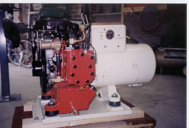

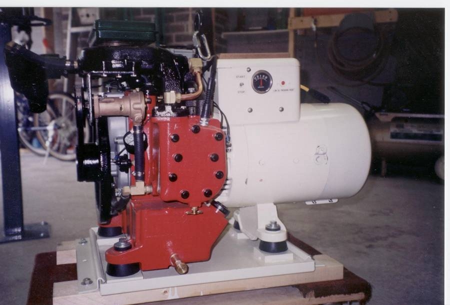

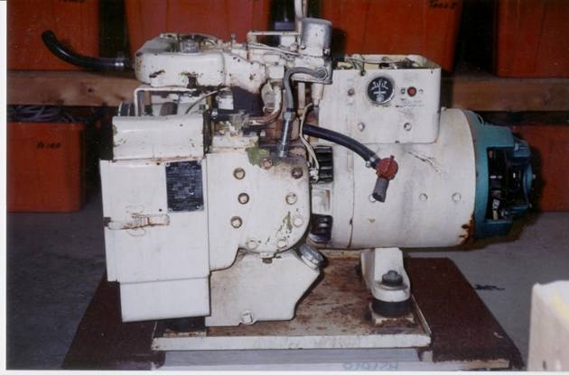

The GenSet on Catherine Ann is the original Onan 6.5 KW with a couple of interesting modifications. It has been completely rebuilt using all original parts (every part still available through Onan/Cummins but ridiculously expensive) I did change the ignition system from the original fully shielded coil, wires and plugs, (which would have been over a thousand dollars to replace) to a system using conventional wires and plugs, plus a GM truck coil. Since the main engines on each side of this generator use conventional ignition systems, having a fully shielded system on the generator did not make sense. (There has been no change in electrical interference with any other systems)
Before
After

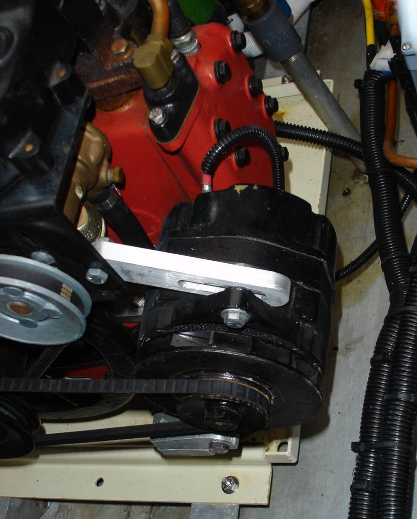

As originally designed, this GenSet uses a 13 HP engine to produce about 50 amps at 120V and about 15 amps at 13.5V to charge the battery. What I really needed was about 80 amps at 13.5V to quickly recharge the house batteries, but I would seldom need more than about 30 amps at 120V. The solution was to mount a marine alternator to the GenSet. This unit takes about 1/3 of the available HP at full load, reducing the 120V amperage available, but quickly charges the 12V house bank at 80 amps, whenever the Genset runs.
