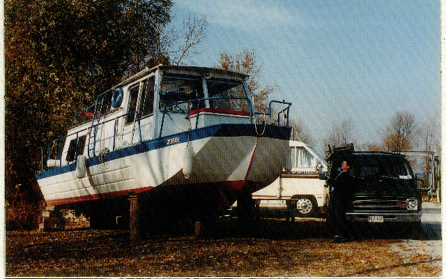

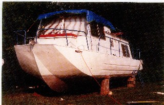

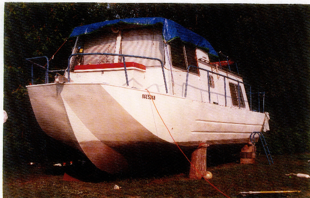

After our third season, i took it upon myself to prepare the hull for painting. Never again. The boat had never been painted below the water line, and was starting to show some minor pitting. Surprisingly the aluminum oxide protected the bottom very well over the 30 years. I disc sanded and cleaned the hull below and above water line, and after priming the bare metal below the water line applied 3 coats of epoxy. Above the water line we primed and painted over the many layers of paint once smoothed, and just last year we applied the missing light blue stripe. We have used the interlux system throughout and it has held well. Our only mishap was that our anti- fouling started to peel after the first season. To my dismay I discovered that I had waited too many days allowing the epoxy to cure, before applying the anti-fouling. According to Interlux, we are now obliged to sand off any remaining anti-fouling product before re-applying with the latest anti-fouling products. Since our boat sits in very clean water, anti-fouling is hardly necessary, and it was suggested to wait a number of years and let the remaining amount wear off as much as possible before re-visiting the hull with sand paper and roller. Good advice.
