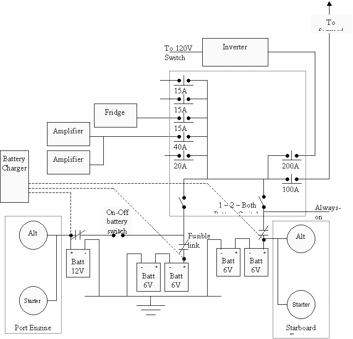

I have my own ideas about what makes a good cruising electrical system.  What I did not want was any sort of reliance on a generator.  To that end, I removed the generator that came with the boat and dropped in 4 Trojan golf-cart batteries and a 1750W inverter.  The batteries are 6V, 225AH lead-acid types.  They each weigh around 65lb.  I removed the 120V stove, the window air-conditioner (yep, a Home Depot special) and the evaporative type fridge.  Interesting to note that the fridge could run on 12V, but it drew 10 amps while running.  We installed a low-power 12V/120V fridge (average draw on 12V is 1.5A) and a Force-10 propane cook-top.  With this setup we can live away from shore power for around 5 days without worrying about power.  If we go into a low-power consumption mode, the batteries should be able to last around 10 days keeping the fridge running.
Battery wiring
The batteries are configured in 3 banks.  There are 2 banks of Trojan golf-cart batteries and 1 cheapie starter battery.  I normally run the golf-cart batteries in parallel to provide 450AH to the house circuits and run them off the starboard alternator.  The port engine only gets the starter battery.  However, I have the battery switches set up so I can split the golf-cart banks apart and move one set over to the port engine for charging.  This allows me to double the charge current if we have really drawn the batteries down from a lengthy stay or use of lots of power (eg power tools, lighting, computer, etc.).  The batteries are wired through to a breaker panel in the aft of the boat with 2ga wire.  There is a separate run of 4ga wire to the main distribution panel in the pilot-house.  The high-power stuff is wired to the aft panel to take advantage of the heavy wire.   The drawing below is the schematic for this setup.
