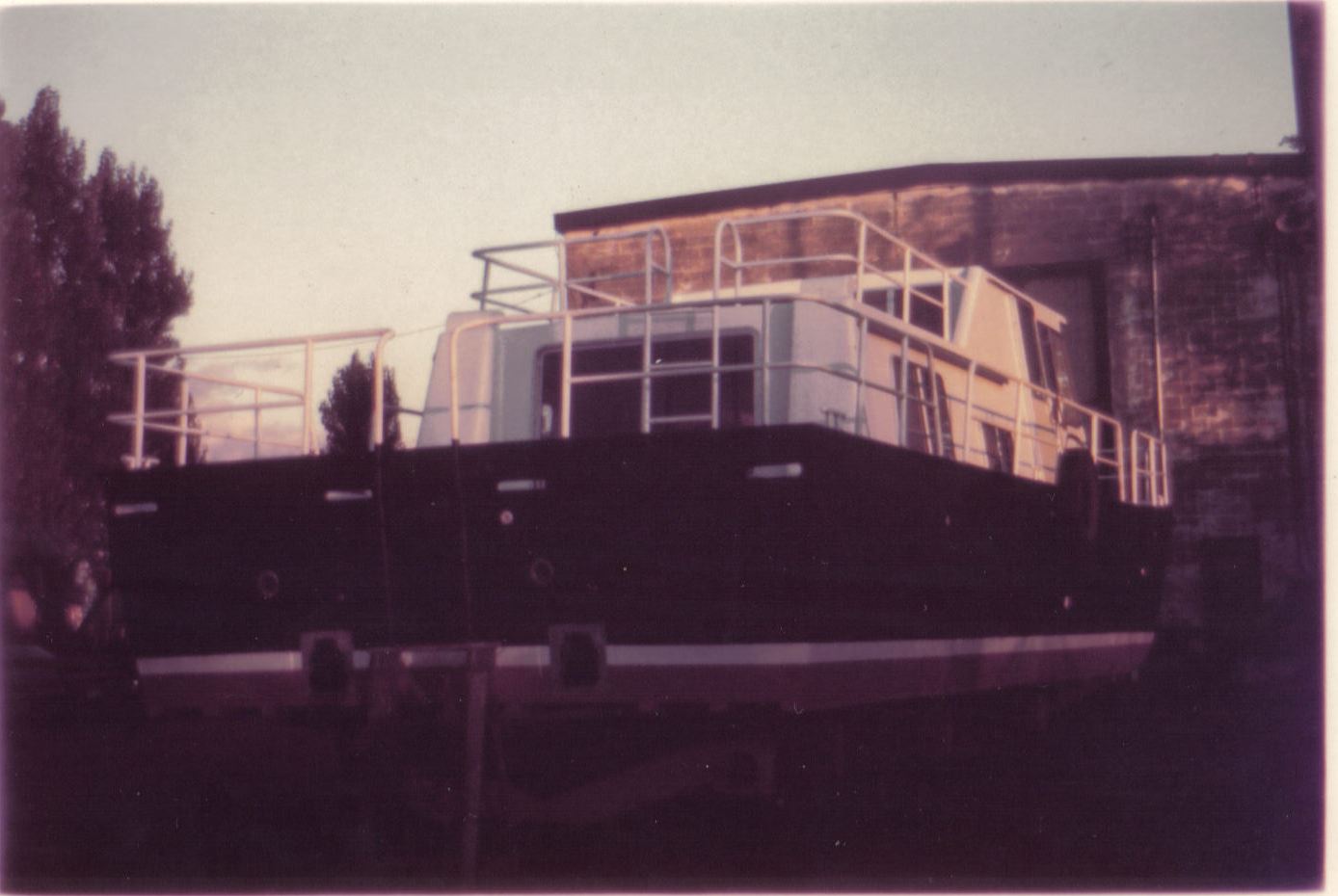

I have been contacted by someone who has history with the Alloy Manufacturing boatyard from this period.  He has provided some additional information and sent me a few pictures of other boats that were made around the same time.
Alloy-Flat_bottom01
Alloy-Flat_bottom02b
